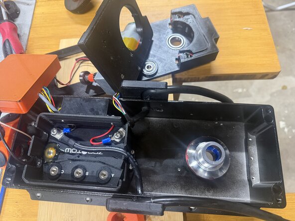

  7. Zerotow Boogie V3 Hull Replacement: step 8, image 1 of 2 Zerotow Boogie V3 Hull Replacement: step 8, image 2 of 2
    • Lift away the control PCB and place upside down
    • Do not unplug anything from the control PCB
    • Unscrew the three motor phase cables
    • The cables are different lengths to make reassembly easier. Shortest first, medium then longest.

  8. Zerotow Boogie V3 Hull Replacement: step 9, image 1 of 2 Zerotow Boogie V3 Hull Replacement: step 9, image 2 of 2
    • Lift the three cables and the breather tube though the slot
    • Be careful to not pinch or cut any of the cables - they are easily damaged
    • Once the cables are inside the slot, the motor can be dropped out of the bottom of the Boogie and put to the side.
