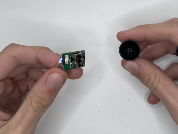

  6. Zelotes C-18 Joystick Replacement: step 6, image 1 of 2 Zelotes C-18 Joystick Replacement: step 6, image 2 of 2
    • Remove the motherboard from the case.
    • Gently disconnect the joystick from its motherboard.
    • Clean the surrounding area and the joystick contacts with a damped cotton swab of isopropyl alcohol.
    Ask FixBot
