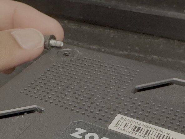

    2. ZOTAC ZBOX MI642 Nano RAM Replacement: step 2, image 1 of 2 ZOTAC ZBOX MI642 Nano RAM Replacement: step 2, image 2 of 2
      • Using your fingers, twist the four padded screws until they are removed.
      • The screws may be tight on first removal. Apply steady pressure while turning to avoid stripping the padded heads.

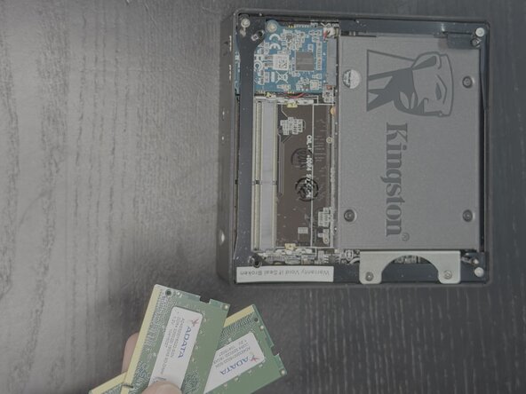

    4. ZOTAC ZBOX MI642 Nano RAM Replacement: step 4, image 1 of 2 ZOTAC ZBOX MI642 Nano RAM Replacement: step 4, image 2 of 2
      • The two SO-DIMM RAM slots are positioned horizontally near the top of the motherboard, just beneath the SSD, side by side.
      • If the device is a barebones unit, the slots will be empty. If RAM is already installed, one or both slots will have a module seated in them.

    5. ZOTAC ZBOX MI642 Nano RAM Replacement: step 5, image 1 of 3 ZOTAC ZBOX MI642 Nano RAM Replacement: step 5, image 2 of 3 ZOTAC ZBOX MI642 Nano RAM Replacement: step 5, image 3 of 3
      • Hold your new DDR4 SO-DIMM module by its edges and orient it so the notch on the gold connector edge aligns with the raised key inside the RAM slot.
      • The module is keyed and can only be inserted in one direction. If the notch does not line up, rotate the module 180 degrees.
      • Confirm your new module is DDR4-2666 or DDR4-2400. The MI642 Nano does not support DDR5. Using an incompatible module will prevent the device from booting.
