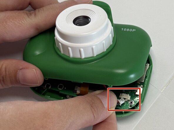

    3. Yeehao Children's Digital Camera Rechargeable Battery Replacement: step 3, image 1 of 2 Yeehao Children's Digital Camera Rechargeable Battery Replacement: step 3, image 2 of 2
      Ask FixBot
    4. Yeehao Children's Digital Camera Rechargeable Battery Replacement: step 4, image 1 of 2 Yeehao Children's Digital Camera Rechargeable Battery Replacement: step 4, image 2 of 2
      • Gently pull the silver lithium-ion battery out of the camera.
      • Remove the yellow plastic around the power connectors.

    8. Yeehao Children's Digital Camera Rechargeable Battery Replacement: step 8, image 1 of 1
      • Plug the power cord back into its socket.
