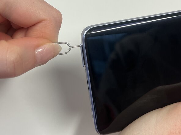

    • Remove the SIM card tray using a SIM card eject tool.
    • Make sure the device is turned off.

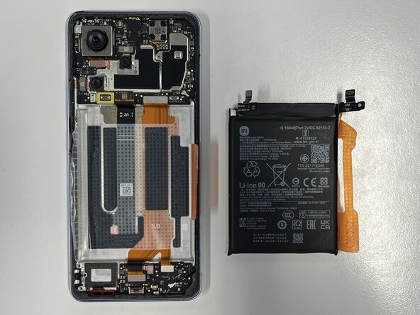

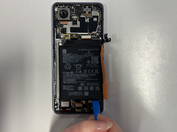

    • Lift up the two press connectors above the battery using an opening tool.
    • Peel off the stickers on either side of the battery.
    • Notice the orange sticker on the right side. It should be separated into two stickers labelled A and B.
    • Pull on the "A" orange sticker to prop up the battery.
    • You can use the opening tool to help prop up the battery if the sticker rips or if pulling on the sticker alone doesn't work.
    Ask FixBot
  8. Xiaomi Redmi Note 13 Pro Plus 5G Motherboard Replacement: step 8, image 1 of 3 Xiaomi Redmi Note 13 Pro Plus 5G Motherboard Replacement: step 8, image 2 of 3 Xiaomi Redmi Note 13 Pro Plus 5G Motherboard Replacement: step 8, image 3 of 3
    • Remove the battery.
    • Peel the sticker by pulling on the "B" orange sticker.
    Ask FixBot
