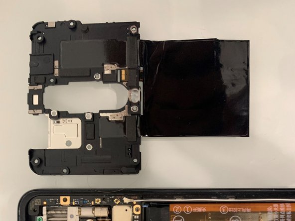

  3. Xiaomi Mi 9T Pro Display Replacement, Remove the upper inner cover: step 3, image 1 of 3 Xiaomi Mi 9T Pro Display Replacement, Remove the upper inner cover: step 3, image 2 of 3 Xiaomi Mi 9T Pro Display Replacement, Remove the upper inner cover: step 3, image 3 of 3
    • Remove the screws and take out the component.
