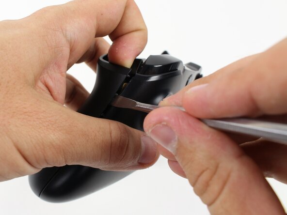

    2. Xbox One Wireless Controller Model 1537 Analog Sticks Replacement, Side Handles: step 2, image 1 of 2 Xbox One Wireless Controller Model 1537 Analog Sticks Replacement, Side Handles: step 2, image 2 of 2
      • We recommend using a nylon spudger for this step. A metal spudger is shown.
      • Grip the controller firmly to remove the side handles, wedging a spudger into the seam between the front and handle plates.
      • Pry the side plate away from the front plate by moving the spudger back and forth. You will need to do this all the way around the side plate's seam.
      Ask FixBot

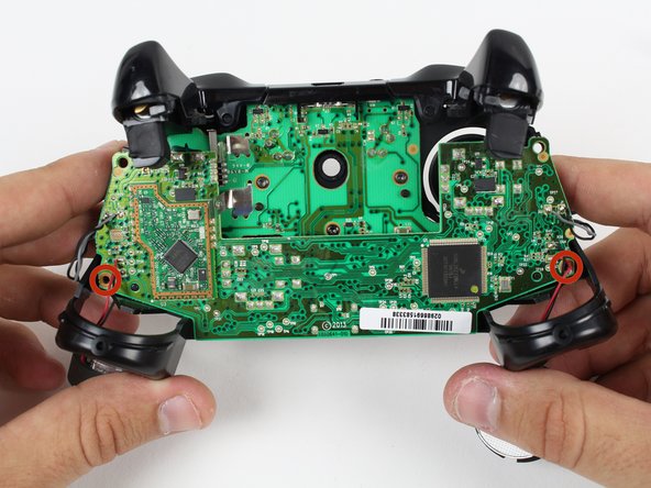

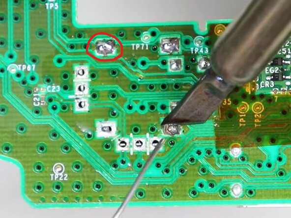

    6. Xbox One Wireless Controller Model 1537 Analog Sticks Replacement, Top Motherboard: step 6, image 1 of 2 Xbox One Wireless Controller Model 1537 Analog Sticks Replacement, Top Motherboard: step 6, image 2 of 2
      • You may let the rumble motors hang freely out of their sockets.
      • De-solder the soldered joints while holding the red and black wires down on the top motherboard.
      • De-solder the black and gray wires that are attached to the top motherboard.
      • Remove the rumble motors and set them aside.
      • Be careful while using the soldering iron not to damage other components or hurt yourself.
      • For information on how to solder, Click Here
      Ask FixBot
    7. Xbox One Wireless Controller Model 1537 Analog Sticks Replacement: step 7, image 1 of 1
      • Unscrew the two 7mm T6 screws located near the rumble motor sockets.
      Ask FixBot
