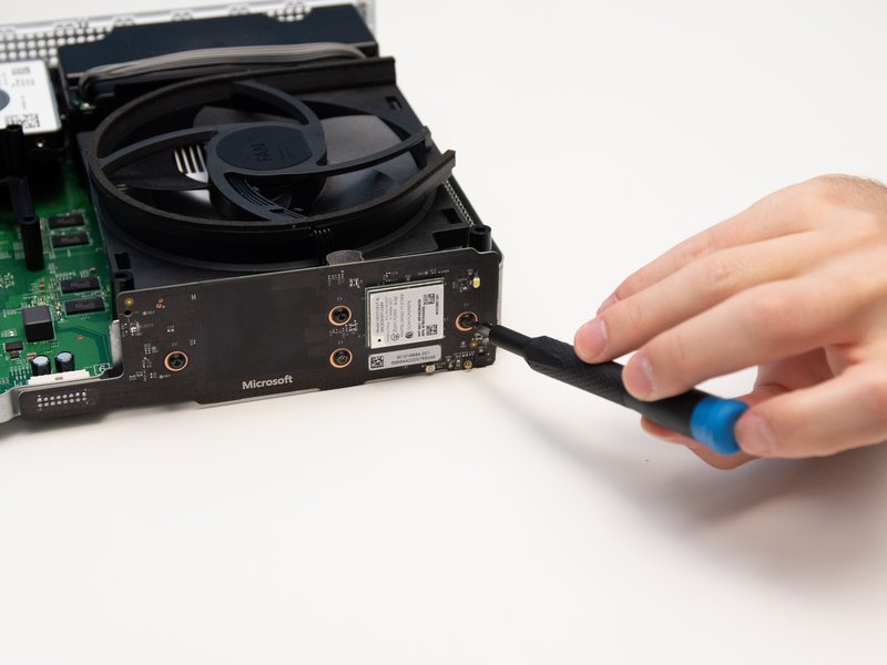

    1. Xbox One S All Digital Edition IR Blaster Replacement, IR Blaster: step 5, image 1 of 2 Xbox One S All Digital Edition IR Blaster Replacement, IR Blaster: step 5, image 2 of 2
      • Remove the four 15mm screws attaching the IR Blaster to the metal chassis with the Torx T8 Security screwdriver.
      Ask FixBot
    2. Xbox One S All Digital Edition IR Blaster Replacement: step 6, image 1 of 2 Xbox One S All Digital Edition IR Blaster Replacement: step 6, image 2 of 2
      • Carefully remove the IR Blaster from the metal chassis.
      • The connector is very fragile. Make sure you pull the board away from the case and not sideways.
