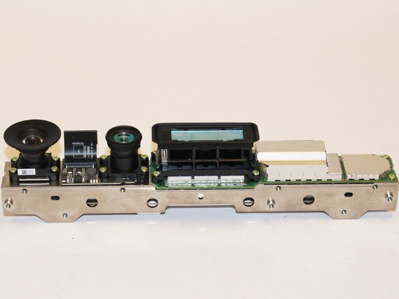

The colour camera is used to capture visual data. It is mounted on the heat sink inside the Kinect.

    1. Xbox One Kinect Colour Camera Replacement, Colour Camera: step 9, image 1 of 3 Xbox One Kinect Colour Camera Replacement, Colour Camera: step 9, image 2 of 3 Xbox One Kinect Colour Camera Replacement, Colour Camera: step 9, image 3 of 3
      • Go ahead and start by removing the Colour Camera's lens cap. This way you can remove the Camera without anything in your way.
      Ask FixBot
    2. Xbox One Kinect Colour Camera Replacement: step 10, image 1 of 2 Xbox One Kinect Colour Camera Replacement: step 10, image 2 of 2
      • Using the T5 screwdriver, remove the four 1.9x10.2 mm screws from the four corners of the camera.
      • With the spudger inserted in between the camera and the metal casing, carefully prop up the camera.
