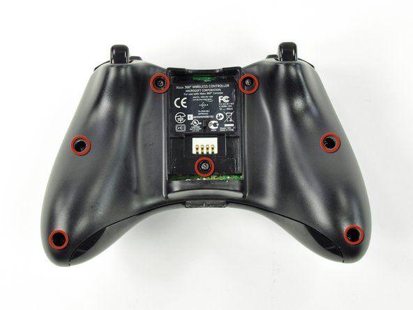

    3. Xbox 360 Wireless Controller battery holder spring Replacement, Back Screws: step 3, image 1 of 1
      • Remove the seven 9.3 mm T8 Security Torx screws securing the rear case to the front case.

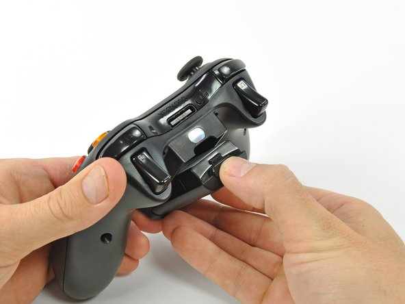

    4. Xbox 360 Wireless Controller battery holder spring Replacement: step 4, image 1 of 2 Xbox 360 Wireless Controller battery holder spring Replacement: step 4, image 2 of 2
      Tool used on this step:
      Spudger
      $2.99
      Buy
      • Insert a spudger between the front and rear cases along the left edge of the controller.
      • Rotate the spudger toward the front of the controller, prying the two cases apart.

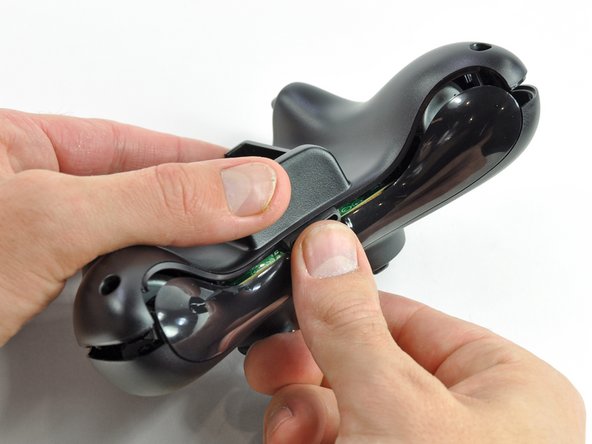

    6. Xbox 360 Wireless Controller battery holder spring Replacement: step 6, image 1 of 2 Xbox 360 Wireless Controller battery holder spring Replacement: step 6, image 2 of 2
      • Grasp the controller by the battery compartment and the headphone jack.
      • Lift the battery compartment away from the headphone jack, separating the rear case from the front case and logic board.
      • The battery contact springs are held in place by slots in the battery housing in the rear case. Be sure to realign them properly during reassembly.
