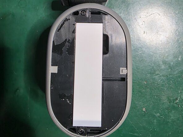

    4. Xbotgo Chameleon Teardown/Battery Replacement, Cleaning adhesive residue from parts: step 4, image 1 of 2 Xbotgo Chameleon Teardown/Battery Replacement, Cleaning adhesive residue from parts: step 4, image 2 of 2
      • Now that you have removed the caps, clean off the adhesive residue and locate the screws.
      Ask FixBot
    5. Xbotgo Chameleon Teardown/Battery Replacement, Screw removal: step 5, image 1 of 2 Xbotgo Chameleon Teardown/Battery Replacement, Screw removal: step 5, image 2 of 2
      • Remove the 2 screws on the first side.
      Ask FixBot

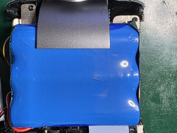

    9. Xbotgo Chameleon Teardown/Battery Replacement, Battery removal: step 9, image 1 of 2 Xbotgo Chameleon Teardown/Battery Replacement, Battery removal: step 9, image 2 of 2
      • Remove the four black Phillips screws located at the corners of the battery and pull it out.
      • Once removed, disconnect the connector by carefully pressing the release tab.
