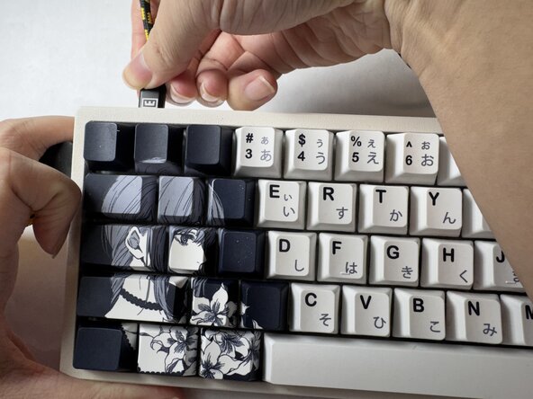

    1. Wooting 60 HE Key Switch Replacement, Key Switch: step 1, image 1 of 2 Wooting 60 HE Key Switch Replacement, Key Switch: step 1, image 2 of 2
      • Unplug the power source.

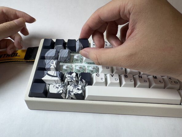

    2. Wooting 60 HE Key Switch Replacement: step 2, image 1 of 2 Wooting 60 HE Key Switch Replacement: step 2, image 2 of 2
      • Clamp the key cap of the faulty switch using a key cap puller, then pull upward until it pops out.

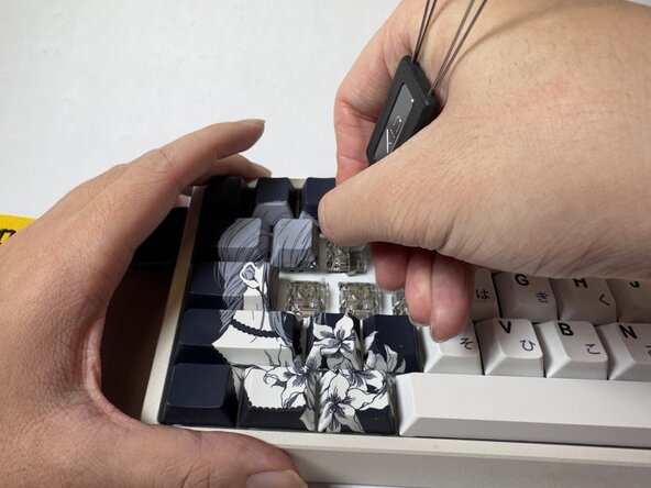

    4. Wooting 60 HE Key Switch Replacement: step 4, image 1 of 2 Wooting 60 HE Key Switch Replacement: step 4, image 2 of 2
      • Clamp the key switch of the faulty switch using a key switch puller, then pull upward until it pops out.

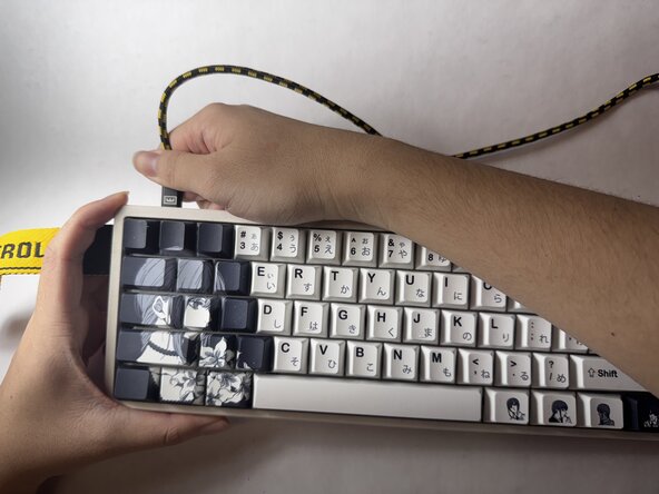

    7. Wooting 60 HE Key Switch Replacement: step 7, image 1 of 2 Wooting 60 HE Key Switch Replacement: step 7, image 2 of 2
      • Reconnect the power cable to the keyboard. Once connected, the keyboard is ready to use.
