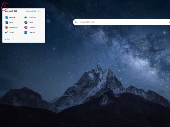

      • Microsoft Office 365
      • Either Google Chrome or Microsoft Edge will work for accessing Office 365. Edge has slightly better integration, so I would recommend this. First of all install Microsoft Edge to access OneDrive files and the Microsoft apps (Word, Excel, PowerPoint, etc).
      • The install isn’t listed in the Software Manager, but you can find it here. Install the Linux (.deb) version.
      • Once Edge is installed, log into Edge using your Microsoft Office 365 credentials.
      • Open a new tab and from the top left click the 9 dots, you can now access your Microsoft apps and OneDrive.
      • For Teams, there is a native app on Linux, just search for Teams from the Start menu. Or go to the Web version of Teams and when prompted to launch/install the app, select yes.
      • There are some serious limitations of the web versions of the apps. Formatting in particular is not accurately retained. There are some features of the desktop versions of the office apps that are not available in the web version. I would recommend using the web apps for a few weeks prior to committing to moving to Linux.
      • Works best when files to edit are kept on OneDrive. More advanced editing, formatting and controls are not available in the web versions. An Internet connection is necessary at all times.
