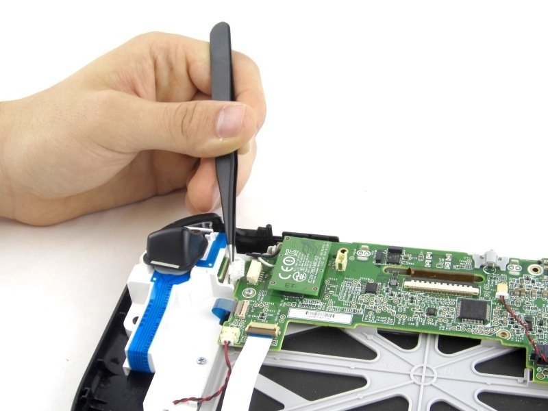

    1. Wii U GamePad Motherboard Replacement, Wi-Fi Board: step 6, image 1 of 3 Wii U GamePad Motherboard Replacement, Wi-Fi Board: step 6, image 2 of 3 Wii U GamePad Motherboard Replacement, Wi-Fi Board: step 6, image 3 of 3
      Tool used on this step:
      Buy
      • Open the top and bottom clasp that connects the white flex cable to the motherboard with the tweezer.
      • Remove the white flex cable with the tweezers.
      Ask FixBot
