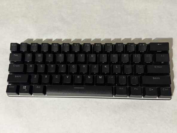

      • Test your keyboard out and identify which keys are not functioning.
      • Take a photo and mark any faulty switches for reference.
      • Confirm the issue is with the switches and not software-related issues.

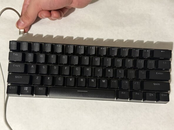

    2. Whirlwind Fx Atom Keyboard Switch Replacement: step 2, image 1 of 3 Whirlwind Fx Atom Keyboard Switch Replacement: step 2, image 2 of 3 Whirlwind Fx Atom Keyboard Switch Replacement: step 2, image 3 of 3
      • Unplug the keyboard from any active cord.

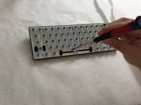

    8. Whirlwind Fx Atom Keyboard Switch Replacement: step 8, image 1 of 2 Whirlwind Fx Atom Keyboard Switch Replacement: step 8, image 2 of 2
      • To solder the new switches, heat the soldering iron.
      • Place the iron wire onto the side of the pins.
      • Apply solder until it forms a small cone shape around the pin.
      • Remove soldering iron and allow the pin to cool off.
      • A good solder join should be smooth not dull or lumpy.
