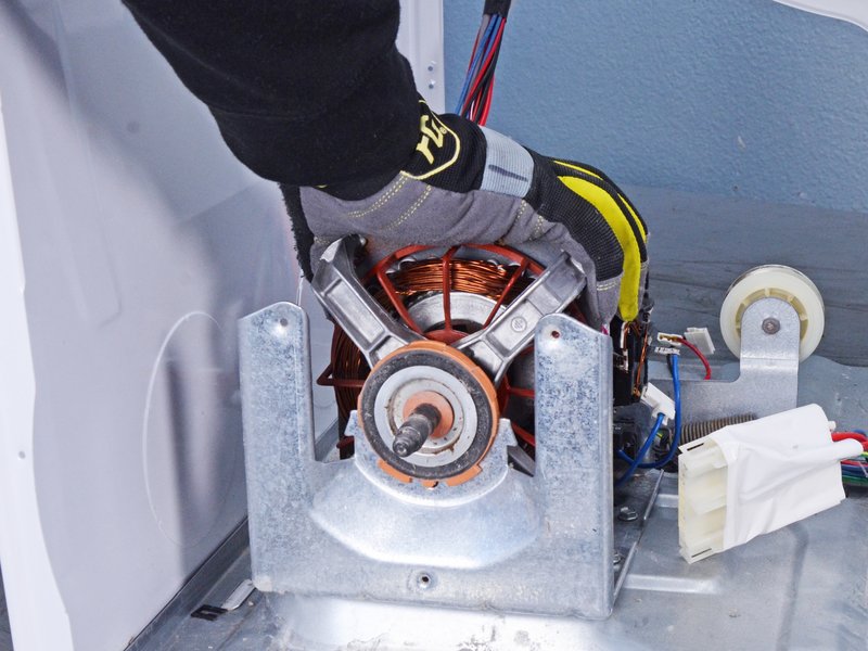

    1. Whirlpool Dryer Motor Testing and Replacement, Unfasten the blower cover: step 27, image 1 of 1
      • The blower cover is the round plate that serves as the inlet to the blower.
      • Unfasten the blower cover screw.
      Ask FixBot
    2. Whirlpool Dryer Motor Testing and Replacement, Remove the blower cover: step 28, image 1 of 2 Whirlpool Dryer Motor Testing and Replacement, Remove the blower cover: step 28, image 2 of 2
      • Lift the blower cover slightly and slide it to free the tabs which hold it in place.
      • Remove the blower cover.
      • The photos show the lower front bulkhead in place. The bulkhead doesn't affect the blower cover removal and reassembly.
      Ask FixBot
    3. Whirlpool Dryer Motor Testing and Replacement, Secure the blower wheel: step 29, image 1 of 1
      • Move to the rear of the machine to access the drive shaft.
      • Hold the drive shaft with an adjustable wrench on the hex portion of the drum drive pulley.
      • The threads on the blower wheel are left-hand threads. The wrench must be installed to the left of the pulley to keep it from rotating counterclockwise.
      Ask FixBot
    4. Whirlpool Dryer Motor Testing and Replacement, Remove the blower wheel: step 30, image 1 of 3 Whirlpool Dryer Motor Testing and Replacement, Remove the blower wheel: step 30, image 2 of 3 Whirlpool Dryer Motor Testing and Replacement, Remove the blower wheel: step 30, image 3 of 3
      • Use a socket wrench with an extension bar and no socket to fit into the square hole on the blower wheel.
      • Turn the wheel clockwise (to the right) to free it enough to remove it by hand.
      Ask FixBot
    5. Whirlpool Dryer Motor Testing and Replacement: step 31, image 1 of 3 Whirlpool Dryer Motor Testing and Replacement: step 31, image 2 of 3 Whirlpool Dryer Motor Testing and Replacement: step 31, image 3 of 3
      • Rotate the blower wheel clockwise by hand until it's free from the motor shaft.
      • Remove the wheel from the blower housing.
      Ask FixBot

    8. Whirlpool Dryer Motor Testing and Replacement, Remove the motor retaining clips: step 59, image 1 of 3 Whirlpool Dryer Motor Testing and Replacement, Remove the motor retaining clips: step 59, image 2 of 3 Whirlpool Dryer Motor Testing and Replacement, Remove the motor retaining clips: step 59, image 3 of 3
      • The next steps will show how to replace the motor.
      • With one hand, press down on the motor retainer clip at the bump on the clip. This should make it easy to unhook the clip from the motor cradle mount.
      • While maintaining the downward pressure, use your other hand to unhook the clip from the motor cradle mount.
      Ask FixBot
    9. Whirlpool Dryer Motor Testing and Replacement: step 60, image 1 of 1
      • Lift the motor retainer clips off the motor and remove it.
      • Repeat the last two steps for the other motor clip.
      Ask FixBot
    10. Whirlpool Dryer Motor Testing and Replacement, Remove the motor: step 61, image 1 of 2 Whirlpool Dryer Motor Testing and Replacement, Remove the motor: step 61, image 2 of 2
      • Lift the motor out of the motor mount and remove it.
      Ask FixBot
