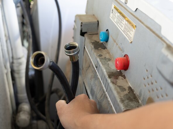

      • Before performing any repairs or replacements, please be aware of your surroundings and ensure you have plenty of safe space to work.
      • Cut the washing machine's water and power before beginning.
      • There will be two valves: one for hot water and one for cold water. Don't forget to unplug the electricity as well.

      • Follow the water line to your washer.

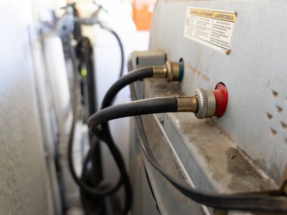

      • Unplug both water lines.
      • Mark which one is for hot water and which is for cold water.

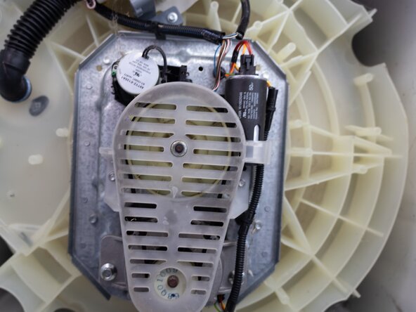

      • Go to the back of the washing machine; you will find the main panel for the drive belt, which is located behind a clear plastic lid.

      • Use the 5/16" Nut Driver to unplug both of the 5/16" hex bolt screw on both sides of the lid and then take the lid out.

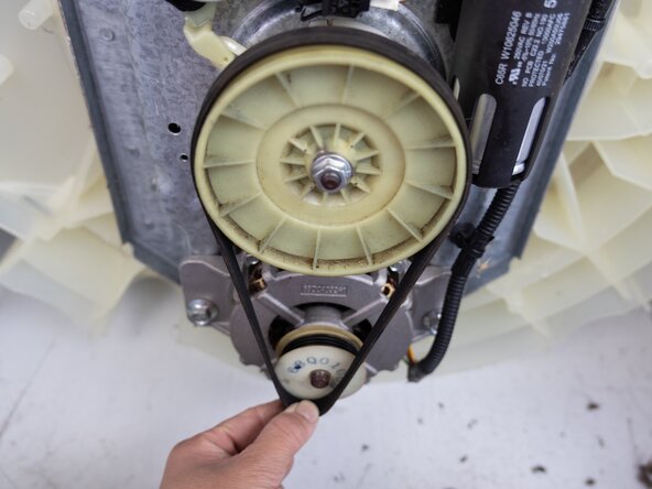

      • After removing the lid, you will find the drive belt of the washing machine.
      • Pull the belt out slowly; it's designed to fit tightly, so this may be difficult.

      • Use a brush or towel to clean the wheel where the belt was.

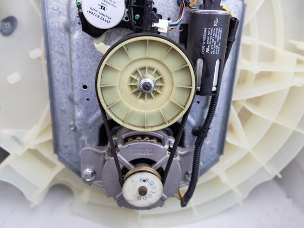

      • Put the new drive belt on, make sure the smooth side faces away from the wheel, and the side with many lines faces toward the wheel.
      • It's essential because the belt needs grip to spin the washer.
