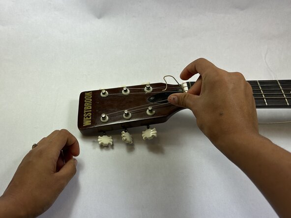

  1. Westbrook FG 5500 Tuning Pegs Replacement, Tuning Pegs: step 1, image 1 of 3 Westbrook FG 5500 Tuning Pegs Replacement, Tuning Pegs: step 1, image 2 of 3 Westbrook FG 5500 Tuning Pegs Replacement, Tuning Pegs: step 1, image 3 of 3
    • Loosen all pegs you plan to replace.
    • Remove the strings so there is no tension on the tuning pegs.
    • If you do not plan on reusing the strings, you can use pliers or a wire cutter to snip the strings to remove them faster.

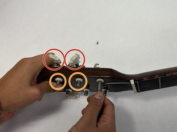

  2. Westbrook FG 5500 Tuning Pegs Replacement: step 2, image 1 of 3 Westbrook FG 5500 Tuning Pegs Replacement: step 2, image 2 of 3 Westbrook FG 5500 Tuning Pegs Replacement: step 2, image 3 of 3
    • Unscrew all three larger screws and corresponding nuts.
    • Unscrew all four of the smaller screws.
  3. Westbrook FG 5500 Tuning Pegs Replacement: step 3, image 1 of 3 Westbrook FG 5500 Tuning Pegs Replacement: step 3, image 2 of 3 Westbrook FG 5500 Tuning Pegs Replacement: step 3, image 3 of 3
    • Remove the tuning pegs by grabbing the white part of the peg and pulling away from the guitar.
    • Slide out the tuning pegs by grabbing the peg from the bottom of the guitar and pulling away from the guitar.
    • Complete the first step 2x times for the remaining tuning pegs.
    • Complete the second step 2x times for the remaining tuning pegs.

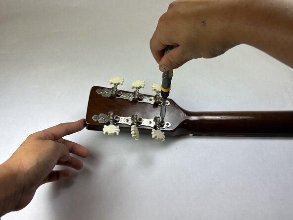

  5. Westbrook FG 5500 Tuning Pegs Replacement: step 5, image 1 of 3 Westbrook FG 5500 Tuning Pegs Replacement: step 5, image 2 of 3 Westbrook FG 5500 Tuning Pegs Replacement: step 5, image 3 of 3
    • Align the new metal plates with the existing holes.
    • Insert the smaller screws into the holes on the metal plate and the guitar head.
    • Use a screwdriver to tighten the screws and secure the metal plate.
