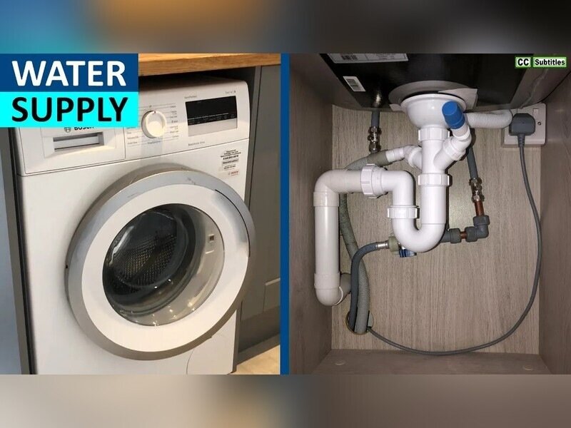

      • If the washing machine is next to a sink, clear the space under the sink so you can see the pipework.
      • Identify the washing machine drainage hose and the power supply inlet water feed hose.
      • Look for the cold water feed with a blue tap fitted to it.
      • The drainage hose carries used water away from the washing machine and isn't the supply hose.
      Ask FixBot
      • Turn the blue tap 90 degrees to shut off the cold water supply to the washing machine.
      • The tap should only turn one way from the open position.
      • Do not force a stiff tap, as old taps that haven't moved for a long time may be hard to turn.
      Ask FixBot
      • If the washing machine isn't next to a sink, pull the washing machine out far enough to access the back.
      • Move the washing machine slowly so you don't stretch, kink, or pull the hoses.
      • Look behind the washing machine for the same type of water supply tap on the inlet hose.
      • Turn the rear tap 90 degrees to shut off the water supply.
      Ask FixBot
      • Use the power supply stopcock if you can't find the washing machine water feed hose or its local shutoff tap.
      • Be aware that closing the power supply stopcock may turn off the water to the whole property.
      • Locate the power supply stopcock before a plumbing emergency so you can shut off the water quickly.
      • Turn the power supply stopcock clockwise to turn the water off.
