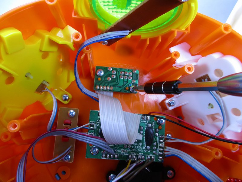

    1. Vtech Move and Crawl Ball Power Switch Replacement, Power Switch: step 5, image 1 of 1
      • Unscrew the two screws to the power switch located beside the circuit board
      Ask FixBot
    2. Vtech Move and Crawl Ball Power Switch Replacement: step 6, image 1 of 3 Vtech Move and Crawl Ball Power Switch Replacement: step 6, image 2 of 3 Vtech Move and Crawl Ball Power Switch Replacement: step 6, image 3 of 3
      • Remove the existing attachments at both ends of the wires with the soldering iron. Heat the solder joint with the solder iron tip and pull the wire.
