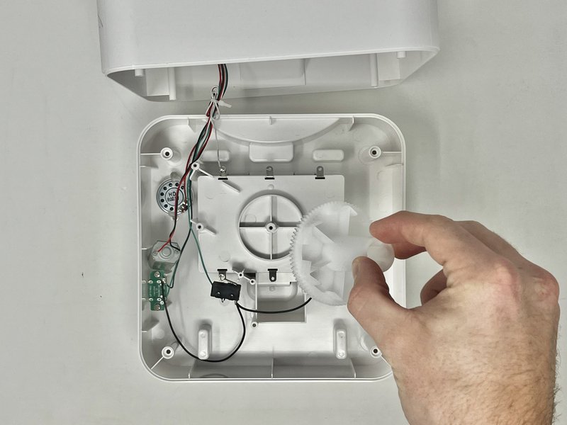

    1. Voluas VL001 Main Drive Gear Replacement, Main Drive Gear: step 6, image 1 of 3 Voluas VL001 Main Drive Gear Replacement, Main Drive Gear: step 6, image 2 of 3 Voluas VL001 Main Drive Gear Replacement, Main Drive Gear: step 6, image 3 of 3
      • Remove the two 11 mm screws that attach the portion switch to the device using a #2 Phillips screwdriver.
      Ask FixBot
    2. Voluas VL001 Main Drive Gear Replacement: step 7, image 1 of 2 Voluas VL001 Main Drive Gear Replacement: step 7, image 2 of 2
      • Using a Phillips #2 screwdriver, remove the single 13 mm screw that is found in the center of the main drive gear shaft.
      Ask FixBot
    3. Voluas VL001 Main Drive Gear Replacement: step 8, image 1 of 3 Voluas VL001 Main Drive Gear Replacement: step 8, image 2 of 3 Voluas VL001 Main Drive Gear Replacement: step 8, image 3 of 3
      • Firmly grab the gear and remove it from the device.
      Ask FixBot
