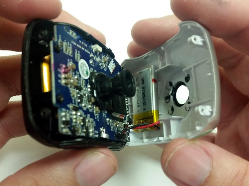

    3. Vivitar DVR 781HD Front Case Replacement: step 3, image 1 of 3 Vivitar DVR 781HD Front Case Replacement: step 3, image 2 of 3 Vivitar DVR 781HD Front Case Replacement: step 3, image 3 of 3
      • Move the plastic opening tool around the seam and apply force at each step to separate the front plate from the back plate and motherboard.
      • The battery is held to the front half of the case with double-sided tape. Peel it up with a finger, being careful not to damage the battery.
