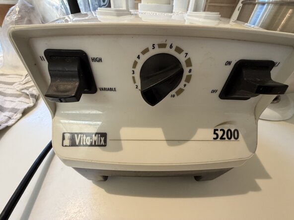

Vitamix 5200 speed control potentiometer replacement

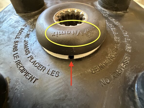

      • Turn the blender around and find the small hole at the back of the drive socket area. Rotate the drive socket so the logo is aligned with the hole.
      • Insert a 2mm or 5/64" hex key through the hole at an angle about 10° above horizontal (using a ball-tip hex drive helps). Back the cap screw out far enough to lift the drive socket free. Set aside.

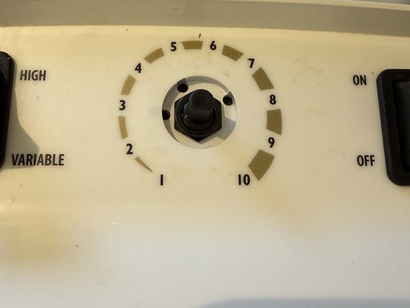

      • Pull the speed control knob straight out from the housing. It is a slip fit.
      • Use a 13mm deep socket to unscrew the retaining nut from the shaft. Set knob and retaining nut aside.
      • Pull the old potentiometer out of the hole from the inside of the housing.

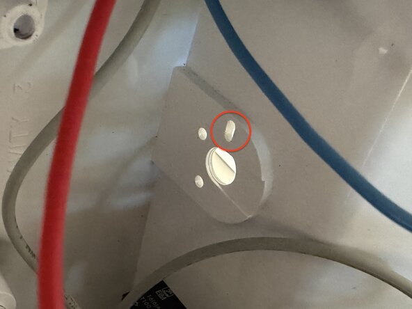

      • The front of the potentiometer has a projecting tab that aligns with a hole in the cover to keep it from rotating when the knob is turned.
      • Insert potentiometer shaft through the hole, aligning the tab with the smaller hole indicated in the photo.
