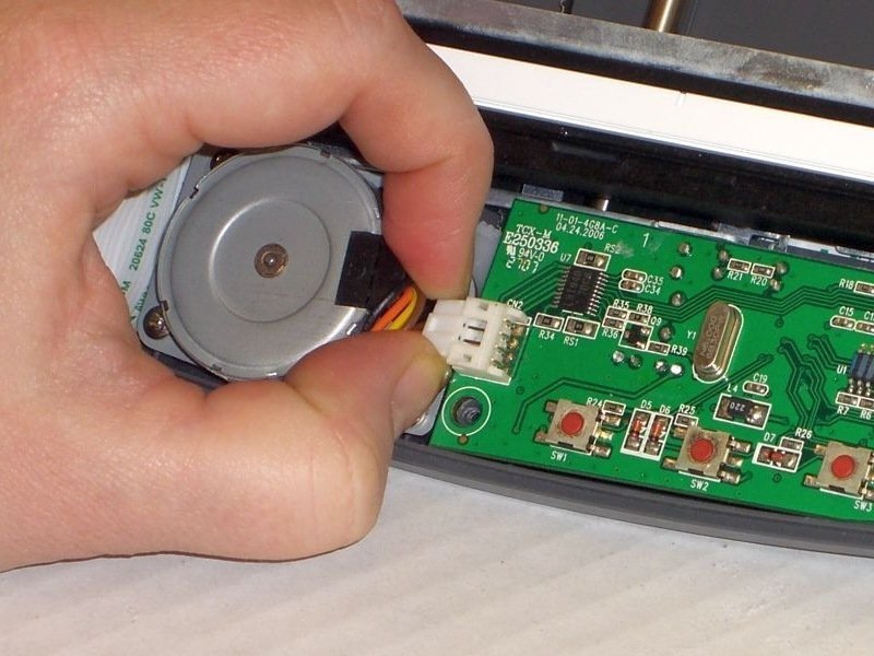

    1. Visioneer OneTouch 7400 USB Motor Replacement, Motor: step 5, image 1 of 1
      • Carefully detach the wires from the motherboard, pulling slowly but firmly.
