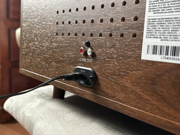

  2. Victrola Century Record Player Stylus/Needle Replacement: step 2, image 1 of 3 Victrola Century Record Player Stylus/Needle Replacement: step 2, image 2 of 3 Victrola Century Record Player Stylus/Needle Replacement: step 2, image 3 of 3
    • Unplug the power cable.
    • MAKE SURE THE POWER IS OFF.

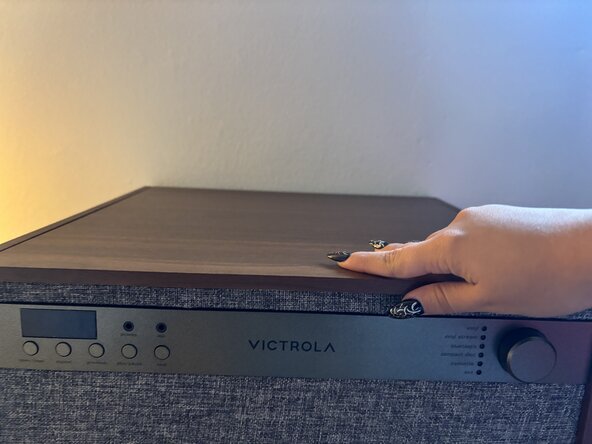

  3. Victrola Century Record Player Stylus/Needle Replacement, Front view of opening the record player's top: step 3, image 1 of 3 Victrola Century Record Player Stylus/Needle Replacement, Front view of opening the record player's top: step 3, image 2 of 3 Victrola Century Record Player Stylus/Needle Replacement, Front view of opening the record player's top: step 3, image 3 of 3
    • Open the top of the record player.

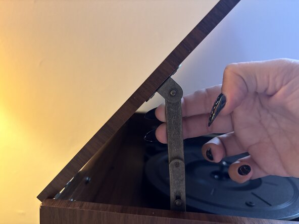

  4. Victrola Century Record Player Stylus/Needle Replacement: step 4, image 1 of 3 Victrola Century Record Player Stylus/Needle Replacement: step 4, image 2 of 3 Victrola Century Record Player Stylus/Needle Replacement: step 4, image 3 of 3
    • Pull the hinge forward to lock it in place so the lid stays open.
    • Do not put your fingers in the hole—you could get pinched.

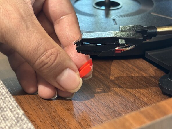

  5. Victrola Century Record Player Stylus/Needle Replacement: step 5, image 1 of 3 Victrola Century Record Player Stylus/Needle Replacement: step 5, image 2 of 3 Victrola Century Record Player Stylus/Needle Replacement: step 5, image 3 of 3
    • Use a spudger to push down on the red cartridge.
    • Pull off the cartridge and stylus.

  6. Victrola Century Record Player Stylus/Needle Replacement: step 6, image 1 of 3 Victrola Century Record Player Stylus/Needle Replacement: step 6, image 2 of 3 Victrola Century Record Player Stylus/Needle Replacement: step 6, image 3 of 3
    • Slide the new cartridge into the headshell and gently press until it clicks into place.
