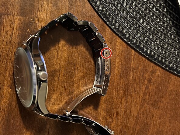

      • Lay the watch on its side just like this.
      • Grab tweezers and poke the hole where the stainless steel meets the band to disconnect the steel holding them together.
      • The pin should come out. This pin is important, so place it somewhere to the side for now. After that, your watch should look like this when laid out flat, allowing you more room to work with to replace your battery.
