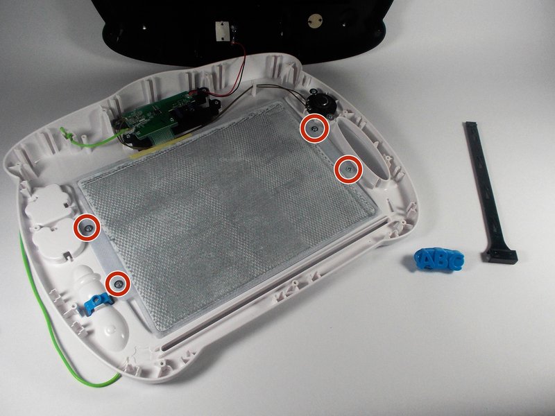

    1. VTech Write and Learn Creative Center Magnetic Screen Replacement, Magnetic Screen: step 3, image 1 of 2 VTech Write and Learn Creative Center Magnetic Screen Replacement, Magnetic Screen: step 3, image 2 of 2
      • Remove the four 5mm PH 0 Phillips screws with 7mm heads holding the screen to the front of the case.
      Ask FixBot
    2. VTech Write and Learn Creative Center Magnetic Screen Replacement: step 4, image 1 of 1
      • Gently push the edges of the screen to remove it from the front case.
      Ask FixBot
