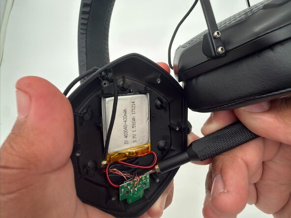

    1. V-Moda Crossfade II Wireless Charging Port Board Replacement, Charging Port Board: step 2, image 1 of 2 V-Moda Crossfade II Wireless Charging Port Board Replacement, Charging Port Board: step 2, image 2 of 2
      • Remove all six 10.1 mm screws that secure the left driver assembly to the frame with a Phillips screwdriver.
      • Lift off the driver assembly with care not to strain the connected wire.

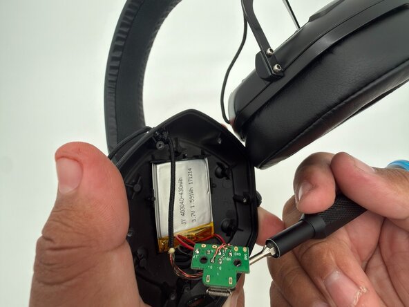

    2. V-Moda Crossfade II Wireless Charging Port Board Replacement: step 3, image 1 of 3 V-Moda Crossfade II Wireless Charging Port Board Replacement: step 3, image 2 of 3 V-Moda Crossfade II Wireless Charging Port Board Replacement: step 3, image 3 of 3
      • Remove the two 5.9 mm screws that secure the charging port board with a Phillips screwdriver.
      • Pop the charging port board out from the top right corner with a spudger.
