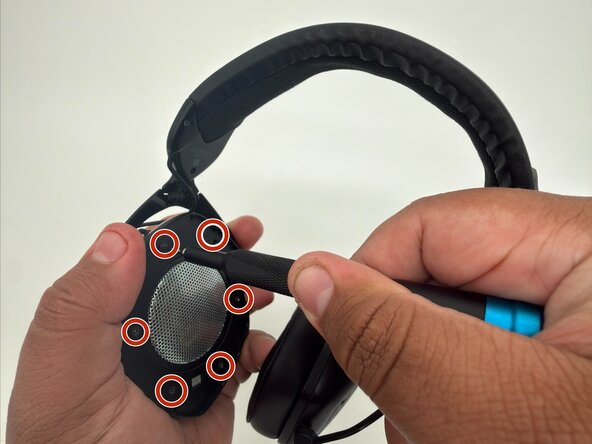

    1. V-Moda Crossfade II Wireless Auxiliary Port Board Replacement, Auxiliary Port Board: step 2, image 1 of 2 V-Moda Crossfade II Wireless Auxiliary Port Board Replacement, Auxiliary Port Board: step 2, image 2 of 2
      • Remove all six 10.1 mm screws that secure the right driver assembly to the frame with a Phillips screwdriver.
      • Lift off the driver assembly with care not to strain the connected wire.
      • The photos incorrectly depict the left driver assembly.

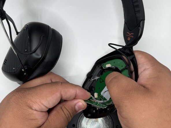

    2. V-Moda Crossfade II Wireless Auxiliary Port Board Replacement: step 3, image 1 of 2 V-Moda Crossfade II Wireless Auxiliary Port Board Replacement: step 3, image 2 of 2
      • Remove the two 5.9 mm screws that secure the aux port board with a Phillips screwdriver.
      • Desolder all of the aux port board connections.
      • Push up on the black locking tabs securing the aux port ribbon cable.
      • Disconnect the ribbon cable.
      Ask FixBot
    3. V-Moda Crossfade II Wireless Auxiliary Port Board Replacement: step 4, image 1 of 1
      • Pull the aux port board out.
