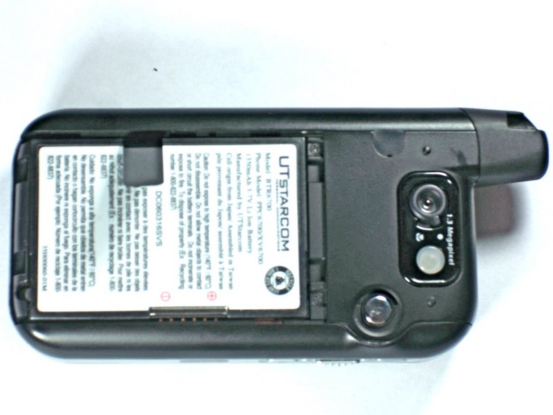

    2. UTStarcom XV6700 Battery Replacement: step 2, image 1 of 1
      • Remove the battery cover by pressing and sliding the cover down and off of the phone.
      Ask FixBot
    3. UTStarcom XV6700 Battery Replacement: step 3, image 1 of 3 UTStarcom XV6700 Battery Replacement: step 3, image 2 of 3 UTStarcom XV6700 Battery Replacement: step 3, image 3 of 3
      • Pull the battery removal tab and lift the battery out of the phone.
      • If the battery removal tab is missing, place a spudger on the opposite side of the highlighted connector and pry the battery up.
      Ask FixBot
