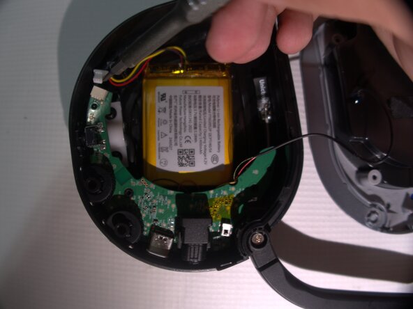

  4. Turtle Beach Stealth 700 Gen 3 Battery Replacement: step 4, image 1 of 1
    • Inspect the connection to ensure the battery is connected securely to the motherboard.
    • If the connector is loose or disconnected, secure the connection and attempt to power on the device.
    • If your headphones are not working after checking the connector, proceed to the next step.
    Ask FixBot
  5. Turtle Beach Stealth 700 Gen 3 Battery Replacement: step 5, image 1 of 2 Turtle Beach Stealth 700 Gen 3 Battery Replacement: step 5, image 2 of 2
    • Use the point of a spudger to push on alternating sides of the connector to "walk" it out of its socket.
    • It may take a lot of alternating before the connector comes out. Be patient, and don't pull on the cables.
    Ask FixBot
  6. Turtle Beach Stealth 700 Gen 3 Battery Replacement: step 6, image 1 of 2 Turtle Beach Stealth 700 Gen 3 Battery Replacement: step 6, image 2 of 2
    • Use a nylon spudger to loosen the adhesive beneath the battery.
    • Remove the battery.
    • Properly dispose of the battery.
