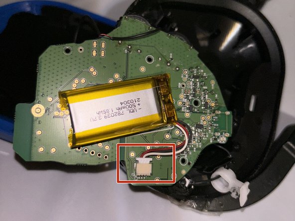

  7. Turtle Beach Stealth 600 Gen 2 Battery Replacement: step 7, image 1 of 3 Turtle Beach Stealth 600 Gen 2 Battery Replacement: step 7, image 2 of 3 Turtle Beach Stealth 600 Gen 2 Battery Replacement: step 7, image 3 of 3
    • Once the battery has been revealed , unclip the old battery and remove it from the board
    • You may use a knife or any other tool to remove the battery from its place since it has tape/glue

  8. Turtle Beach Stealth 600 Gen 2 Battery Replacement: step 8, image 1 of 2 Turtle Beach Stealth 600 Gen 2 Battery Replacement: step 8, image 2 of 2
    • Once the battery has been removed, clip in the new battery into the white component and place the battery into the board
    • The new battery will either have a sticky side or tape to place onto the board

Where can I find the replacement battery? Thanks!
Luke - Reply Share
I found them on Ebay and Amazon for the 600
Battery for Turtle Beach Stealth 600 2Gen P/N: VDL782039
J Hogan - Reply Share
If you are reading this and are looking to replace the battery for a Turtle Beach Stealth 600 Gen 3 headset; note that the battery is in the right earpiece and is even easier to access due to fewer wires. The battery in my gen 3 headset was a "Li-ion Polymer Battery", Model No FT593545P, 3.7v, 1050mAh
