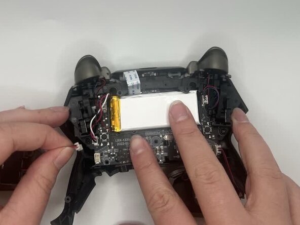

  4. Turtle Beach Recon Cloud Vibration Motors Replacement, Vibration Motors: step 4, image 1 of 2 Turtle Beach Recon Cloud Vibration Motors Replacement, Vibration Motors: step 4, image 2 of 2
    • Unplug the vibration motor cable connector from the motherboard.
    • If the connector doesn't come out easily, use the point of a spudger to push on alternating sides of the connector to "walk" it out of its socket.
    • It may take a lot of alternating before the connector comes out. Be patient, and don't pull on the cables.
    • Be careful as the connector may be tough to pull out. If so, wiggle it out of the socket.
