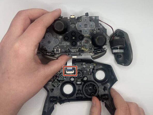

    2. Turtle Beach Recon Cloud Action Buttons Replacement: step 7, image 1 of 2 Turtle Beach Recon Cloud Action Buttons Replacement: step 7, image 2 of 2
      • Lift out the motherboard at an angle to detach it from the clips securing it to the case.
      • Don't lift the motherboard roughly or pull on it. There is a ribbon cable attached to the motherboard and front case.
      • Use a spudger or a clean fingernail to flip up the locking flap of the ZIF connector—this is the unlocked position.
      • Use tweezers or your fingers to gently pull the cable out of its socket.
