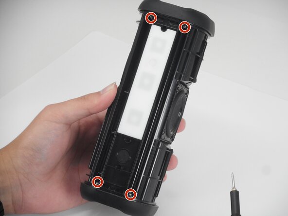

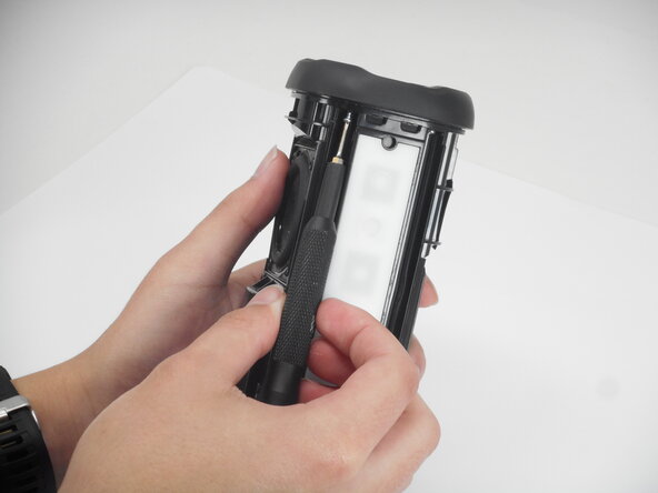

    3. Tribit Stormbox IC-BTS30 Front Panel Replacement: step 3, image 1 of 3 Tribit Stormbox IC-BTS30 Front Panel Replacement: step 3, image 2 of 3 Tribit Stormbox IC-BTS30 Front Panel Replacement: step 3, image 3 of 3
      • Use a Phillips #00 screwdriver to remove the 11.4 mm screws along the panel.
      • Gently lift the rubber control panel away from the housing.
