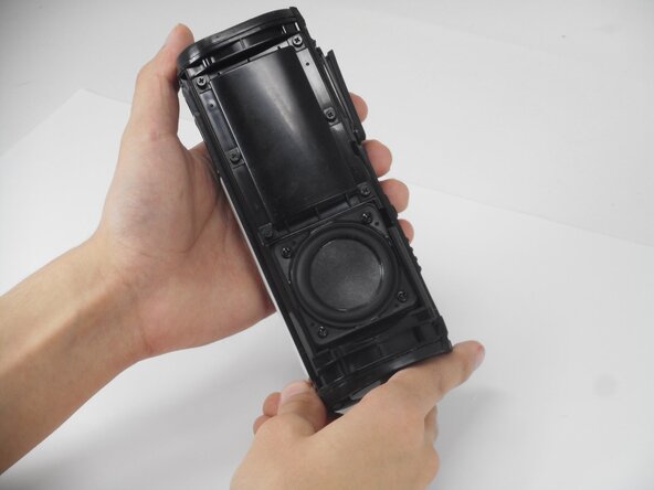

    1. Tribit Stormbox IC-BTS30 Drivers Replacement, Drivers: step 4, image 1 of 3 Tribit Stormbox IC-BTS30 Drivers Replacement, Drivers: step 4, image 2 of 3 Tribit Stormbox IC-BTS30 Drivers Replacement, Drivers: step 4, image 3 of 3
      • Rotate the Tribit StormBox, with the middle driver facing out.
      • Remove the four 7.7 mm screws securing the driver with a Phillips #2 screwdriver.
      • Gently lift the driver out with care not to strain the connections.
