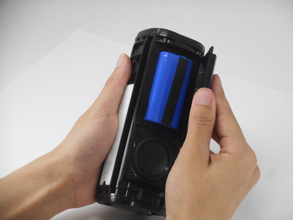

    1. Tribit Stormbox IC-BTS30 Battery Replacement, Battery: step 4, image 1 of 3 Tribit Stormbox IC-BTS30 Battery Replacement, Battery: step 4, image 2 of 3 Tribit Stormbox IC-BTS30 Battery Replacement, Battery: step 4, image 3 of 3
      • Rotate the speaker so the exposed internal side is facing you and is easy to work on.
      • Use a Phillips #1 screwdriver to remove the six 7.9 mm screws securing the internal frame and speaker driver to the housing.
      • Lift out the battery cover.

    2. Tribit Stormbox IC-BTS30 Battery Replacement: step 5, image 1 of 3 Tribit Stormbox IC-BTS30 Battery Replacement: step 5, image 2 of 3 Tribit Stormbox IC-BTS30 Battery Replacement: step 5, image 3 of 3
      • Turn the speaker so the Tribit logo faces you directly.
      • Use a plastic opening tool to gently pry up the top cover.
      • Remove the top cover to reveal wires connected to the circuit board.

    3. Tribit Stormbox IC-BTS30 Battery Replacement: step 6, image 1 of 3 Tribit Stormbox IC-BTS30 Battery Replacement: step 6, image 2 of 3 Tribit Stormbox IC-BTS30 Battery Replacement: step 6, image 3 of 3
      • Unplug the battery connector from the board.
      • Remove the battery.
