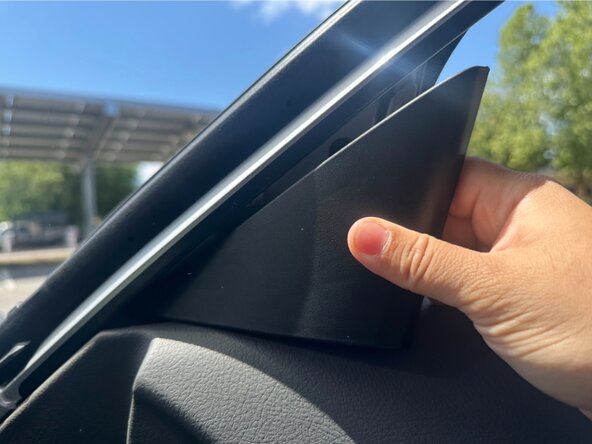

Toyota Camry 2008 Side Mirror Replacement
  1. Toyota Camry 2008 Side Mirror Replacement, Side Mirror: step 1, image 1 of 3 Toyota Camry 2008 Side Mirror Replacement, Side Mirror: step 1, image 2 of 3 Toyota Camry 2008 Side Mirror Replacement, Side Mirror: step 1, image 3 of 3
    • Remove the trim piece from the inside of the door.
    • The trim piece should be easy to pull off without too much pressure. If you struggle, you may use another item to gently pry it off.

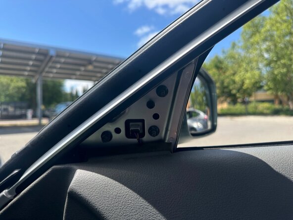

  2. Toyota Camry 2008 Side Mirror Replacement: step 2, image 1 of 3 Toyota Camry 2008 Side Mirror Replacement: step 2, image 2 of 3 Toyota Camry 2008 Side Mirror Replacement: step 2, image 3 of 3
    • Remove the connector by pushing the tab in and then pulling out the connector.
    • You can use an additional tool to help push the tab in if you can't push it in with your fingers.
    • Be careful to not pull on the wires; pull at the base to prevent damaging the connector.

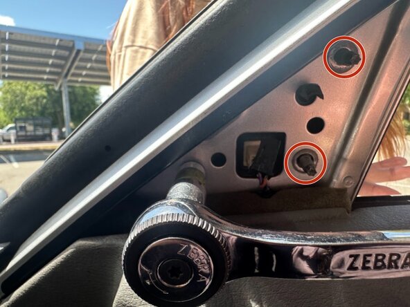

  3. Toyota Camry 2008 Side Mirror Replacement: step 3, image 1 of 3 Toyota Camry 2008 Side Mirror Replacement: step 3, image 2 of 3 Toyota Camry 2008 Side Mirror Replacement: step 3, image 3 of 3
    • With a 10mm socket wrench, remove the three nuts.
    • As you are removing the nuts, the mirror becomes loosened. Make sure you are holding onto the mirror to prevent it from falling.

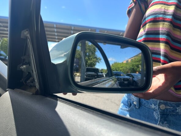

  4. Toyota Camry 2008 Side Mirror Replacement: step 4, image 1 of 2 Toyota Camry 2008 Side Mirror Replacement: step 4, image 2 of 2
    • Remove the side mirror.
    • Hold it with a good grip as you pull it away from the car door to prevent the sockets from getting loose.

  8. Toyota Camry 2008 Side Mirror Replacement: step 8, image 1 of 2 Toyota Camry 2008 Side Mirror Replacement: step 8, image 2 of 2
    • Put the trim piece back on.
    • Make sure the trim is secured to the car door so it does not fall off.

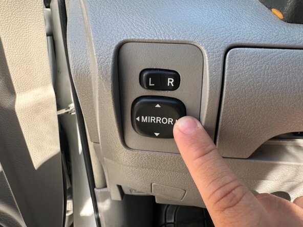

  9. Toyota Camry 2008 Side Mirror Replacement: step 9, image 1 of 3 Toyota Camry 2008 Side Mirror Replacement: step 9, image 2 of 3 Toyota Camry 2008 Side Mirror Replacement: step 9, image 3 of 3
    • Test the connection with buttons.
    • Make sure that the button is switched to the side that is being tested and it's moving in the correct direction.
