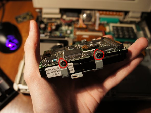

    10. Toshiba T2400CS Hard drive Replacement, Remove the hard drive: step 10, image 1 of 1
      • 10.A) Undo the screws holding the hard drive bracket in place
      • 10.B) Slide the hard drive toward yourself to release it from the connector
      Ask FixBot
    11. Toshiba T2400CS Hard drive Replacement: step 11, image 1 of 2 Toshiba T2400CS Hard drive Replacement: step 11, image 2 of 2
      • Undo the screws on each side of the bracket and your hard drive is free!
      • To reassemble the computer with a new hard drive, repeat the steps backwards.
