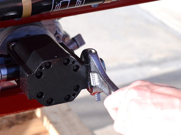

    6. Toro Log Splitters 22618HD 2019 Pump Replacement, Disconnect the hose from the pump: step 9, image 1 of 2 Toro Log Splitters 22618HD 2019 Pump Replacement, Disconnect the hose from the pump: step 9, image 2 of 2
      • Use two adjustable wrenches to loosen the nut holding the input hose to the fitting on the right side of the pump.
      • Using one adjustable wrench to hold the nut closest to the pump steady, use the second adjustable wrench to loosen the nut on the hose.

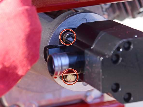

    10. Toro Log Splitters 22618HD 2019 Pump Replacement, Remove the pump: step 13, image 1 of 2 Toro Log Splitters 22618HD 2019 Pump Replacement, Remove the pump: step 13, image 2 of 2
      • Use a 1/2 inch wrench to remove the four bolts securing the pump to the flex coupler housing.
      Ask FixBot
    11. Toro Log Splitters 22618HD 2019 Pump Replacement: step 14, image 1 of 3 Toro Log Splitters 22618HD 2019 Pump Replacement: step 14, image 2 of 3 Toro Log Splitters 22618HD 2019 Pump Replacement: step 14, image 3 of 3
      • Remove the pump.

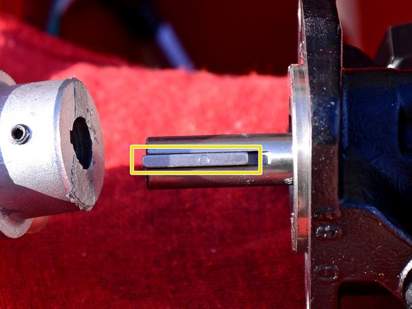

    13. Toro Log Splitters 22618HD 2019 Pump Replacement: step 16, image 1 of 3 Toro Log Splitters 22618HD 2019 Pump Replacement: step 16, image 2 of 3 Toro Log Splitters 22618HD 2019 Pump Replacement: step 16, image 3 of 3
      • Pull the pump-side flex coupler away from the pump input shaft to remove it.
      • Keep track of the pump shaft key. Transfer it to the replacement pump only if the new part does not come with a new key.
      • Only the pump remains.
