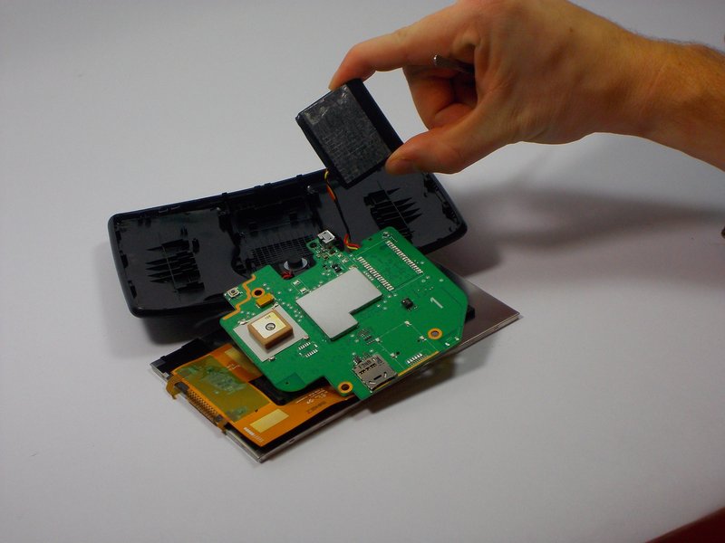

    3. TomTom VIA 1605TM Battery Replacement: step 7, image 1 of 2 TomTom VIA 1605TM Battery Replacement: step 7, image 2 of 2
      • Unplug the wire connecting to the battery by pinching the sides connected to the front screen.
      • Pull back away (in the opposite direction) from the connector.
      • Lift the circuit board to reveal the battery beneath.
      • When reassembling push back into connector. Do not need to pinch anything. The "click" sound insures solid connection.
      Ask FixBot
    4. TomTom VIA 1605TM Battery Replacement: step 8, image 1 of 2 TomTom VIA 1605TM Battery Replacement: step 8, image 2 of 2
      • Carefully pry loose using the plastic opening tool and remove the original battery.
      • Place the new battery where the old battery was located.
