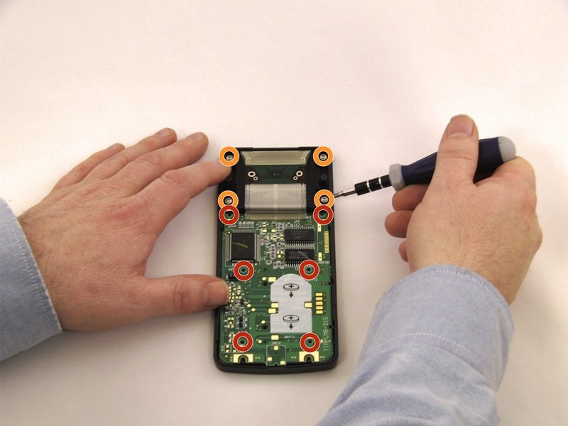

    1. Texas Instruments TI-80 Motherboard and Screen Replacement, Motherboard and Screen: step 4, image 1 of 2 Texas Instruments TI-80 Motherboard and Screen Replacement, Motherboard and Screen: step 4, image 2 of 2
      • Using a Philips PH0 screwdriver, remove the 6 screws. 2 from the top of the Motherboard, 2 from the middle, and 2 from the bottom of the Motherboard.
      • Using a Phillips Ph0 screwdriver, remove 4 screws from the screen mount.
      • Using the blue plastic opening tool, pry the Motherboard up.
      • Using the blue plastic opening tool, pry up the screen from the screen mount.
