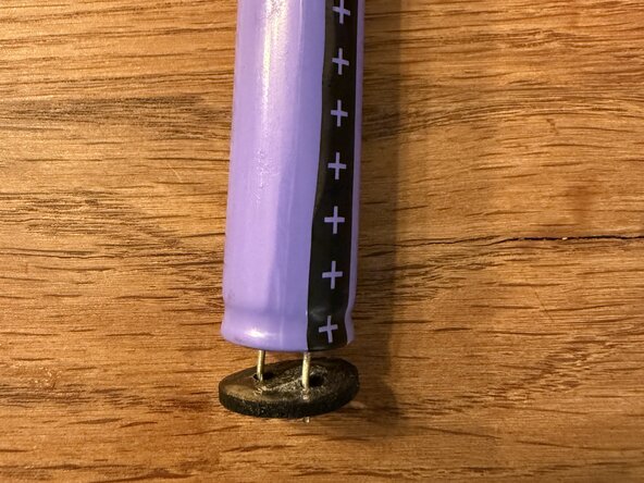

This guide shows the replacement of the LTO (Lithium-Titanium-Oxide) replacement battery of a Tempest Weather Station WF-TWS01.
The required spare part is not very easy to obtain (LTO replacement battery 2.4V, 18650 format, min. 1300mAh or higher).
You should avoid using a standard Li-ion battery, as these are not designed for the wide temperature range.

    3. Tempest Weather Station replacement battery replacement, Install the rubber spacer: step 4, image 1 of 2 Tempest Weather Station replacement battery replacement, Install the rubber spacer: step 4, image 2 of 2
      • Save the rubber spacer that was mounted under the old battery and slide it onto the battery tabs of the new replacement battery.
      Ask FixBot
      • Place the replacement battery with the rubber spacer onto the circuit board, ensuring the correct polarity, and then solder it in place.
      • Trim the solder tabs to approximately 2 mm from the circuit board, then apply a small amount of fresh solder to the cut ends of the tabs to prevent corrosion.
      Ask FixBot
