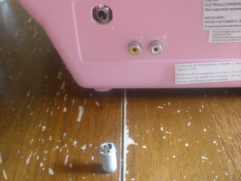

I've repaired this problem several times using this method and it works well.
Tools
    1. Television Coaxial Connector Replacement, Coaxial Connector: step 1, image 1 of 1
      • Kids pulled the cable connector off the back of the hello kitty TV

      • Use a soldering iron, and solder sucker to remove excess solder from the connector area. You can also use solder-absorbing braided wick.
      Ask FixBot
    7. Television Coaxial Connector Replacement: step 7, image 1 of 1
      • identify, where the centre pin connector was ripped from the board.
      • Use needle-nose pliers to straighten out the tin bracket as much as possible. It does not need to be perfect, but this helps with the alignment of the connector to the back of the tv cover.
      Ask FixBot
    8. Television Coaxial Connector Replacement: step 8, image 1 of 1
      • Align the connector, ensuring the center pin can reach the the spot on the board where it needs to be re-connected.
      • Solder the barrel of the connector to the metal bracket first, try not to let it get too hot. You may want to use a solder gun with dual heat of at least 50 watts for this part.
      • When that's done don't forget to solder the center pin to the board using as little solder as possible, to ensure there's no grounding to the metal cover.
      Ask FixBot
