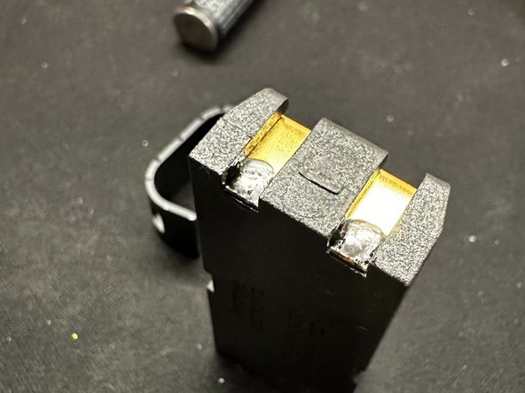

  2. Teenage Engineering PO-33 Battery compartment Replacement, Prepare battery holder: step 2, image 1 of 3 Teenage Engineering PO-33 Battery compartment Replacement, Prepare battery holder: step 2, image 2 of 3 Teenage Engineering PO-33 Battery compartment Replacement, Prepare battery holder: step 2, image 3 of 3
    • The battery holder I used is meant for surface mounting. Bend and break off the four (4) flat parts. Cutting might work too.
    • Tin each of the four (4) terminals

  3. Teenage Engineering PO-33 Battery compartment Replacement, Wire up the PO: step 3, image 1 of 3 Teenage Engineering PO-33 Battery compartment Replacement, Wire up the PO: step 3, image 2 of 3 Teenage Engineering PO-33 Battery compartment Replacement, Wire up the PO: step 3, image 3 of 3
    • Measure out some length of wire routing it as pictured.
    • The PO expects both batteries to face the same way! Like most battery compartments, this one alternates which side the negative goes on.
    • I had the bottom ones fully stripped because they didn't need to cross.
    • Tin the battery pads.
    • Tin your wires
    • Solder the wires as pictured
    • Add a piece of foam tape
