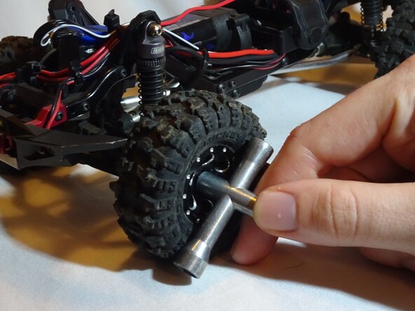

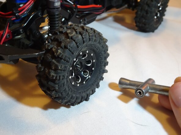

    2. TRAXXAS TRX-4M Shock Replacement: step 2, image 1 of 3 TRAXXAS TRX-4M Shock Replacement: step 2, image 2 of 3 TRAXXAS TRX-4M Shock Replacement: step 2, image 3 of 3
      • Gently undo the wheel nut using the Traxxas 4-way wrench.
      • Remove the loose wheel nut by hand or using the Traxxas 4-way wrench.
      • Remove the tire from the drive shaft by hand.
