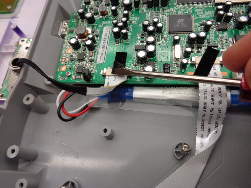

    1. Sylvania SDVD9004 Screen Replacement, Screen: step 4, image 1 of 3 Sylvania SDVD9004 Screen Replacement, Screen: step 4, image 2 of 3 Sylvania SDVD9004 Screen Replacement, Screen: step 4, image 3 of 3
      • Disconnect ribbon
      • This guide uses incorrect tools. Use an ESD safe tool, such as a nylon spudger, to complete this step.
      • Rotate screwdriver to peel sticker from ribbon.
      • Place spudger head behind gray tabs on port.
      • Press outward to disengage tab.
      • Repeat on other side.
      • Slide out ribbon.
