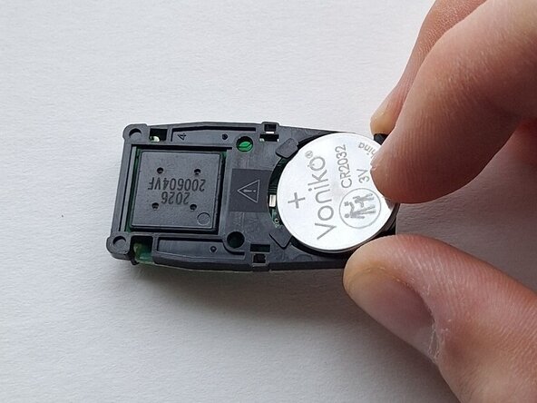

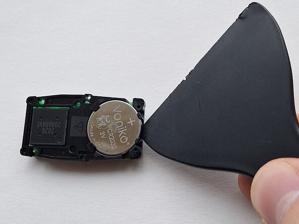

    4. Subaru Smart Key Fob Model 14AHK Battery Replacement: step 4, image 1 of 1
      • Use a plastic pry tool to lift the battery out of place.
      • Remove the old battery.
      • Use gentle pressure here to avoid breaking the clips that hold the battery in place.
      Ask FixBot

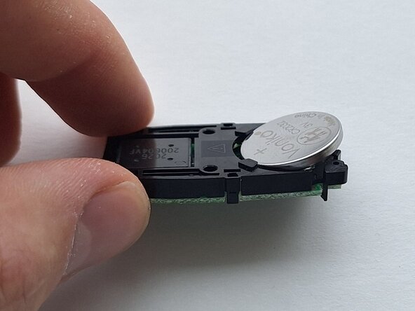

    5. Subaru Smart Key Fob Model 14AHK Battery Replacement: step 5, image 1 of 2 Subaru Smart Key Fob Model 14AHK Battery Replacement: step 5, image 2 of 2
      • Insert the new battery at an angle.
      • Press down on the raised side of the battery until it snaps into place.
      Ask FixBot
