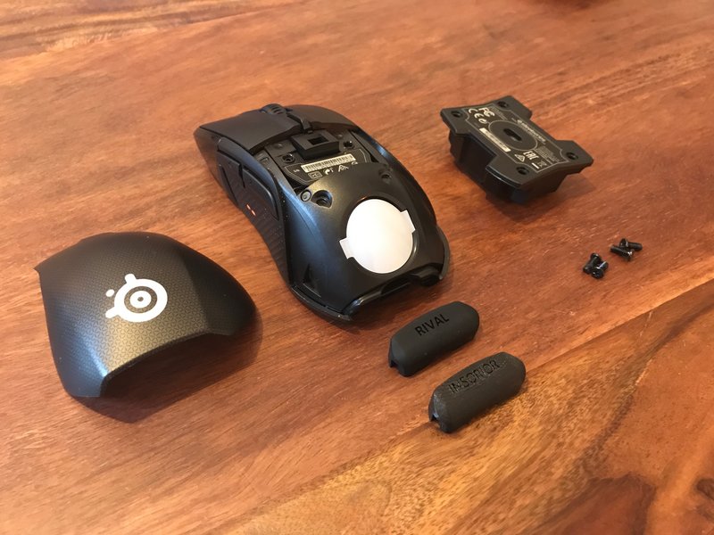

    1. Steelseries Rival 700 Gaming Mouse Disassembly, Sensor screws: step 7, image 1 of 2 Steelseries Rival 700 Gaming Mouse Disassembly, Sensor screws: step 7, image 2 of 2
      • Use a Philips #0 screwdriver to remove the four screws that are keeping the mouse sensor assembly sealed.
      Ask FixBot
    2. Steelseries Rival 700 Gaming Mouse Disassembly, Sensor removal: step 8, image 1 of 1
      • Insert your thumb and index in the two mouse holes and gently pry the sensor assembly out from its socket.
      Ask FixBot
    1. Steelseries Rival 700 Gaming Mouse Disassembly, Sensor socket: step 9, image 1 of 1
      • The sensor assembly is linked to the mouse body with a 10-pin Steelseries custom connector.
      Ask FixBot
    2. Steelseries Rival 700 Gaming Mouse Disassembly: step 10, image 1 of 1
      • Only four screws have to be removed to entirely re-design this gaming mouse, which is not that expensive regarding the high performance, features, and customizability.
