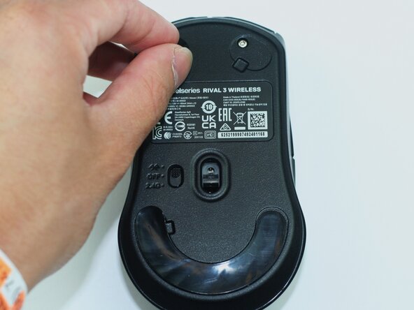

      • Flip the mouse upside down.
      • Locate the wireless mode switch on the bottom.
      • Slide it to the OFF position.
